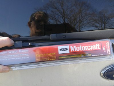

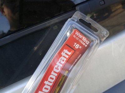

I have totaled just under 8K on my new truck and have found another instance where the part number listed in the Owners Manual is wrong. The manual lists the rear wiper replacement as a Motorcraft # WW-1612. THIS IS INCORRECT!

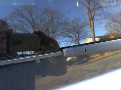

The first pic is the way it came from the factory for reference:

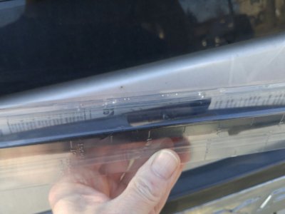

In the next two pics that the 1612 wiper is a completely different style.Orig rear wiper.jpg specified wiper 1612.jpg ww-1612 wiper specified but won't fit!.jpg WW-1614 wiper will fit!.jpg
The correct wiper is the WW-1612 as shown fit perfectly!
I hope this helps someone from buying the wrong wiper BECAUSE THEY FOLLOWED THE OWNERS MANUAL!

Instead of "The correct wiper is the WW-1612 as shown fit perfectly!" do you mean the correct wiper is the WW-1614? I'm asking because I have this same wiper arm on a 2016 Ford Expedition Limited and I ordered the WW-1612 and it doesn't come close to being the correct wiper blade.
May 12, 2018
Oregon or Arizona
Well Jeff Kushner I guess now you understand now the manual can get something like that wrong... Seeing how you did the exact same thing. I think most people figured out that you meant to say that the WW-1614 is the correct part number.
