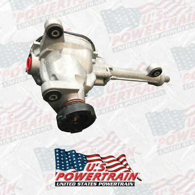

The dealership recently informed my I need my front differential replaced or rebuilt. I took it in for the growling noise others have posted here. They indicated they pulled some fluid from the differential and it had a significant amount of metal shavings. I changed the fluid after the trip to the dealership. Replacing to fluid had no affect on the sound as it was still there. I will try looking at the wheel hubs and the IWE's to see if any noise is coming from there.
Question , has anyone replaced the front differential ? I know they can be rebuilt but I prefer to just buy the full unit and swap it out vs replacing individual bearings, races, etc. I found the link below where this guy is removing one on a F150. I assume its similar but I don't want to get into the project without understanding the full picture.
Also has anyone bought a differential from US Powertrain? There are some used on ebay but I would pay a bit more and have the peace of mind.
Thanks
Q
