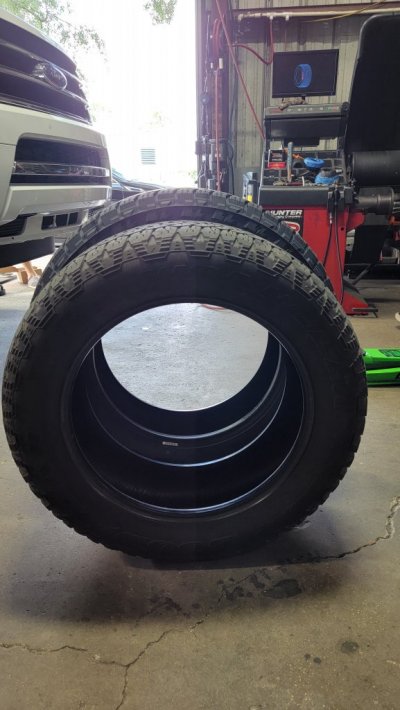

I knew I wanted to do a a subtle lift so spent a fair amount of time and research on what direction to take. The current Goodyear Wranglers were really starting to show their age, previous owner kept with the 275/55/20 OEM size. The rear shocks were also leaking, even though they were new when I bought it.
So what better time for some upgrades!?
Here it sits with my other 2 cars, all slightly modified. So wanting to keep this comfortable and quiet since it's the main family hauler. Btw, I'm a real-estate agent with the Gearhead Homes team, we specialize in working with big garage homes for fellow car enthusiasts.
Time for upgrades!

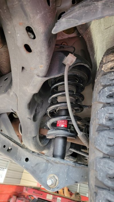

3/2 Readylift
KYB Excel G shocks
SPC Camber nuts for alignment
1.5 aluminum, hub centric wheel spacers
275/65/20 Nitto Terra Grapplers (SL, non E rated version)

Spc camber nuts? Haven't heard of that. Does that help with the alignment after the leveling kit? My 2014 with 2.5" gets wobbly at times. I'm taking it in for another alignment to see if we can get it riding better. I wonder if that's something I should look into?
mjp2
Apr 19, 2017
440
279
Howell, NJ
It's worth it. Ford also sells a similar kit but will ding you $330 for the 4 bolts and alignment tabs. Go aftermarket.
Not that your factory bolts may be rusted in place so replacing the bolts may involve replacing the lower control arms.
