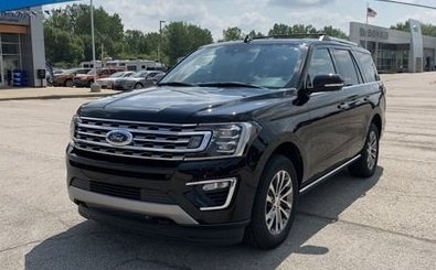

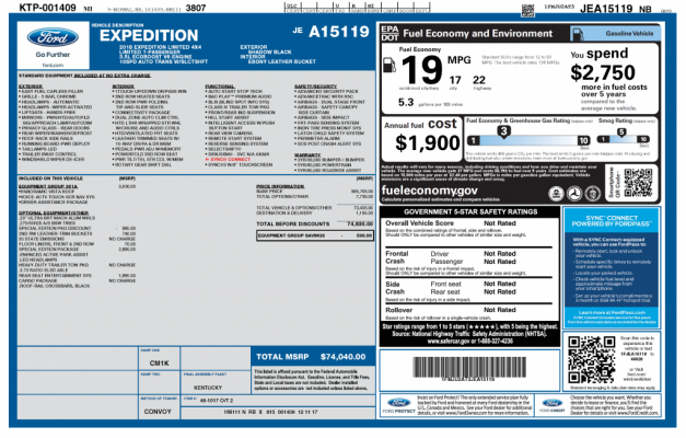

I am currently looking at this Expedition. 2018 Limited with 301A, Special Edition, and HD Tow Packages. 1-owner trade-in with just under 60k miles for about $48k. What do you guys think? Is the 60k mile service a major maintenance milestone?
Can anyone tell me if this one has CCD? And also what exactly is CCD and how does it impact towing and everyday driving?

CCD is adaptive damping for 22" wheels.

- the expy will have better handling. As far as ride goes, I felt the 17 nav l w/o ccd has the best overall balance btw plush and control. My expy didn't have ccd(it was like the one you posted) and the ride was great but a tad inconsistent, one day it's extremely absorbent, the next day you feel every crack in the road. The 17 nav with ccd was also good, but did wander a bit too much for my liking. The ccd in the new nav doesn't wander as much and I'd assume that the expy ccd feels somewhat similar.
