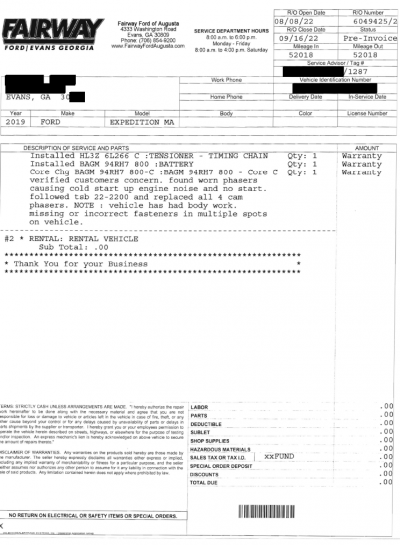

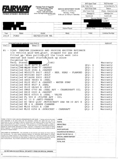

Update!!! I just spoke with the Ford dealership and they let me know they did do the software update in October. And it is covered as a one time fix for the cam phaser. So I'm waiting to see how much the cost would actually be to replace it, since they updated the software and that's what it covered only.
AJ82
Feb 1, 2022
234
145
Here is the info on it. It should be 100% covered before 69,999 miles since the software update was completed.
