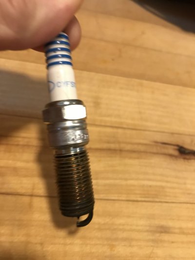

The FIRST time you had a plug and coil replaced, they should have done them all. That was 90% of your issue. The current replacement plug in the catalog, and what your 2018 came with are DIFFERENT plugs. The originals weren't good, and the replacements are worse. There are many threads(Even recently) covering this. There are NGK options, and they are night and day better from the current Motorcraft options. People have seen improved performance and MPG switching to them.

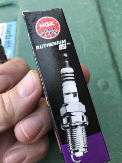

I just purchased set of these plugs and saw they were made in Japan… I assumed by NGK.

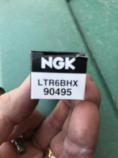

The NGK website recommends 90495, but they will need to be re-gapped. I saw a colder plug recommended here, but not sure if it should be used on a stock engine

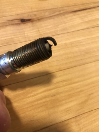

Assuming will get you nowhere. Look at the stock MC plug vs the NGK recommended in several threads on here. There is a BIG difference.
Yep, the colder NGK is what I recommend, even stock. Difference is gap. Run the stock gap, if not tuned.
