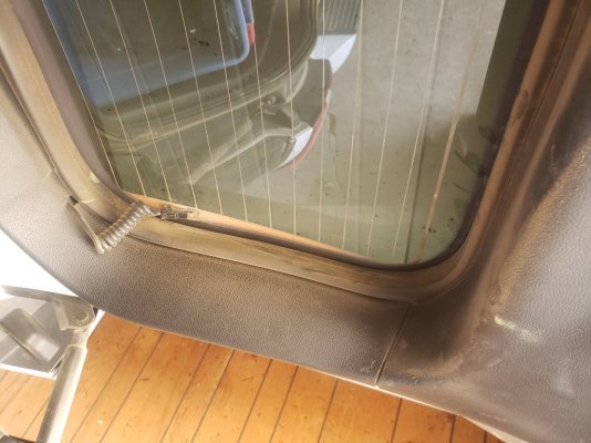

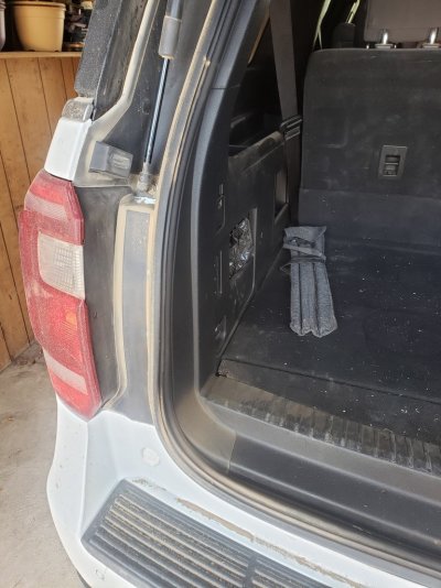

Generally use outside air.20251025_124053.jpg20251025_124056.jpg20251025_124103.jpg20251025_124114.jpg
It's definitely the weather strip at the back door
Here's some pictures where you can see the dust on the inside of the seal
But the seals look fine, they don't feel stuff or dried out
This vehicle has only 100k(km) on it
