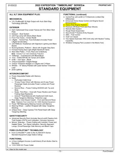

Ordered and received my 2022 Limited expedition 304A with HD tow package. I had assumed that would include an upgraded radiator, is this not the case?? It had been included in previous years and is included in the 2023 HD tow package. There was not an (add on) box that I saw to upgrade the radiator like you can on the 23’s so just assumed it came with the package. I thought it was listed in the package when I ordered but the 2022 order guide that I just saw says it was omitted?? Had planned to get a travel trailer ( the reason I added the tow package) and now concerned I will have issues.

Order guide is pretty vague with regards to this. I'd presume with the 3.5HO it would have the heavy duty radiator. The only place I can find the words "heavy duty radiator" are on the Timberline description.

where does the order guide say that the heavy duty radiator is excluded from the 304a with HT tow?
It neither specifies included nor excluded on the build sheet or window stickers. But the fact that it doesn't mention included in the build guide or window sticker sounds like it isn't.

Only way to check would be to get part numbers using VIN from say a XLT and a 304a Limited and see if the radiator part number matches.
