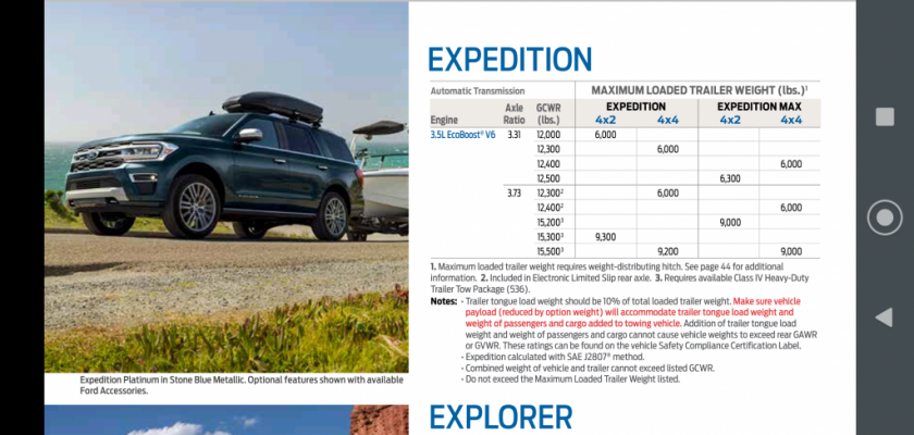

The 2022's are just getting to dealer lots and some lucky folks. So there isn't going to be lots of payload data on them yet. I'd expect the payloads to be similar to previous model years but won't know that until some people can post their payload stickers.
As for towing, the Ford towing guide states that the non-HD tow are limited to 6,000 lbs towing and 600 lbs tongue weight (except for the 4X2 Max which is 6,300 and 630). If you want more you need the HD tow package. Now could it do more, perhaps but that isn't Ford's line.
