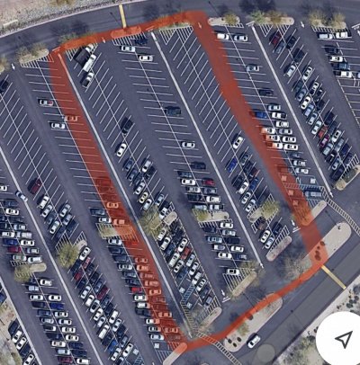

Kept trying it in the street. I had to find a big parking lot. Wound up using 3 drive isles, and about 25 car slots in length for a 18' boat. Just driving around in circles.FEF4E99E-9CF9-443D-BE5D-432D9AF0DDB5.jpeg
