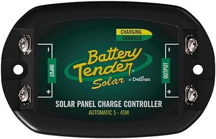

(One note. Last year I added a small solar panel and battery tender. This works, but it's a pain to set up AND only works if it is sunny.)

Those older vehicles didn't have nearly the KOEO (key on, engine off) demand on the battery that your new 2023 does. And you are correct, every time you open the door the vehicle wakes up and everything turns on. Do that multiple times over the course of a few days without starting or driving the vehicle and you see the result, dead battery. Your solar battery tender is a really good idea. As someone else suggested, you need to start and run the vehicle for a good 15-20 min each day (or maybe more).
