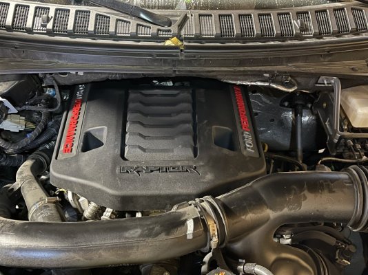

I've read that the engine in the Stealth Performance model expy (440 hp) is the same as the F150 Raptor engine. Would the Raptor engine cover fit the Expy?
Has anyone done this.
I think it might look bad ass
And it's honest because it's the same engine!

It'll fit perfectly. Agreed that it would look awesome!

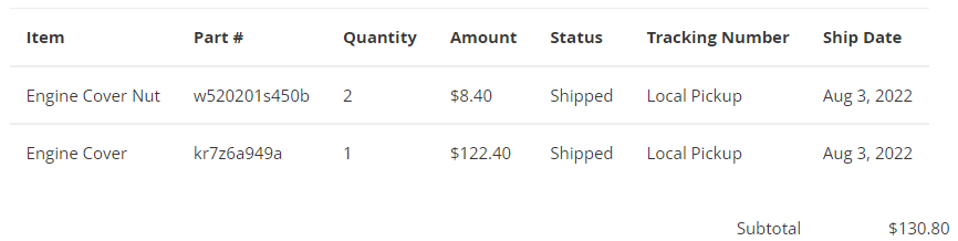

Does anyone have the part#?
I have ford pass rewards kicking around and have been looking for something to use them on.

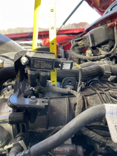

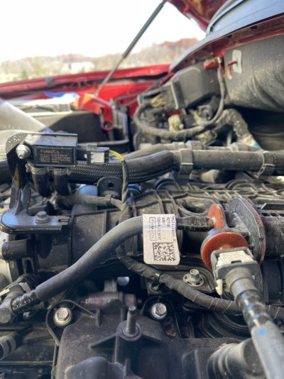

I purchased it, and it will not fit on the SPP. There is a bracket with cables on top of the intake, attached to the rear of the throttle body that prevents the cover from fitting down onto the intake. I ended up giving the cover to my son who installed it on his F150 with the 3.5L Ecoboost. Fit his engine perfectly.
Here are the part numbers -

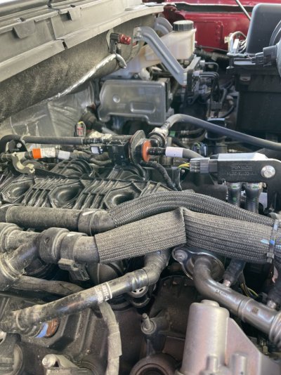

Here are a few pics of the Raptor engine in my SPP. Note the device, I believe related to the EGR system, sitting over 3.5inches above the top of the intake. This is why the Raptor cover will not fit. I even tried trimming a portion of the cover out in an attempt to make it fit. No luck.

By "SPP" do you mean Stealth performance package?
Thanks for the info.
