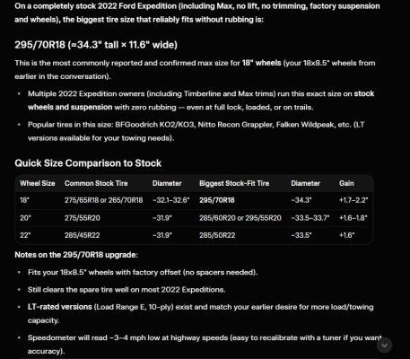

I got the TPMS and have been running these wheels/tires since shortly after the last post; they came with General Grabber A/T tires and I love them! They bolted right up and no clearance issues/rubbing. Don't think I'll ever put the 22" back on as the ride with the 18" is so much better.
Question - anyone happen to know what might be the largest (similar A/T) tire I can mount without rubbing/trimming? I have NOT done any lift/suspension mods yet. TIA!
I asked Grok about it and it spat out this chart.
What you think about the noise for those tires inside the Expedition; do you notice it with the windows up?
