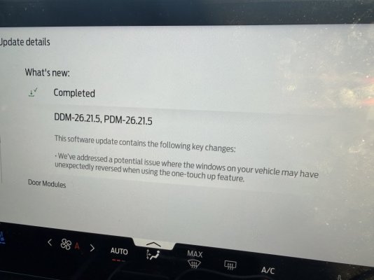

Having a random issues with passenger window, front row. Twice I have had the window spontaneously bounce back when raising the wondow. It has happened twice in two months and the reset procedures all over google dont work. Anyone else with this or have a solution?
