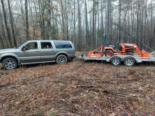

I'm partial to the Michelin LTX A/T-2 275/65R20 tires that are on my Excursion (Using 2014 SuperDuty Platinum wheels.)
I can find them all day long at any local tire shop.
They tend to last a long time.
They tend to be quiet on the highway.
I want to put them on my Expedition.
I don't care about ride quality. I'm used to the Excursion with its leaf springs and solid axles. Never had a cavity, so I don't have fillings to rattle out.
I don't care about fuel economy. I'm used to the Excursion with its V10, 4 speed transmission, and my heavy right foot. Anything over 9 MPG will be an improvement.
Though they DO tend to get stuck on wet grass, perhaps a suggestion of a real All Terrain tire would be good.

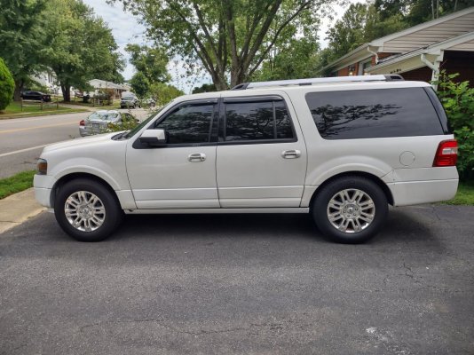

The P275/55R20 Tires I pulled off of my Expedition said 44 PSI max.
65 PSI no es bueno.
I have swapped them out for LT275/65R20 Tires with an 80 PSI max pressure rating.
No rubbing at full steering lock.
She sits about an inch higher.
