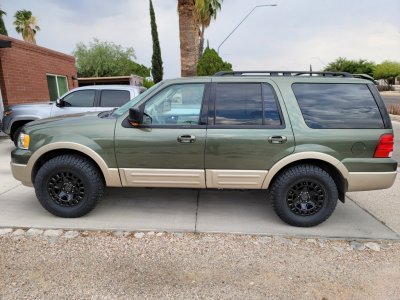

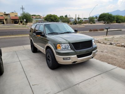

I see this question asked a lot so I figured I could help. I just put a set of 285/70r17 Nitto Ridge Grapplers on my stock height Expy and it has zero rubbing even at full lock. The rims are Black Rhino Yorks with 12mm offset.

I've got almost the same - 285/75/17 Terra Grapplers with no issues, on an 04 4x4 XLT SSV.
