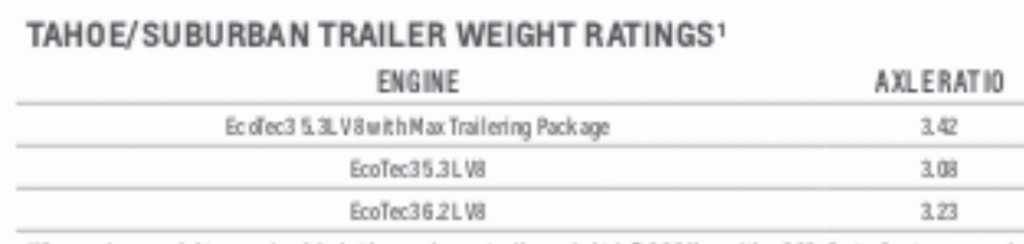

I'm going to buy or lease a 2019 Expedition. What I'm finding is an abundance of "towing packages" on the vehicles I'm interested in. I won't be towing. What's the downside of having that option besides the additional up front cost? I'm planning a few highway trips at first then mostly in town driving.
Here you go

There's a couple of threads on here already about this. Folks have strong opinions. The chart #16plati posted is really all you need to know...the rest is just opinions.
