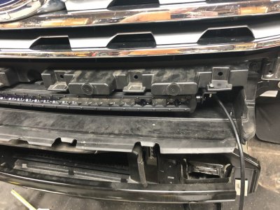

I'm working on getting my 30" LED Lightbar installed and I thought I'd drop a quick teaser pic while I'm working on it! It fit excellent and you can't see it unless you bend down and look in the bumper for it.
The pic, the bumper cover is just slipped on (for a quick pic), so its not on perfectly straight and whatever....
This should help the stock wimpy LED headlights a ton being 12,000 Lumens!

This is a Pavement Princess, it can stay on. I'm getting the FX4 skids tho to keep the snow out of the engine.

Here's how I mounted it, nothing fancy at all. Just a couple stainless steel bolts and lock nuts I had laying around. I'll probably add a small brace from the bottom tomorrow, so it doesn't jiggle. Man, the whole front of this thing is just such flimsy plastic junk, there was nearly nothing to secure anything too. Its pretty sad, but it the day and age of junk we live in. I'm sure every manufacturer is similar....
The Lightbar curve is almost exactly the same curvature as the bumper, so it really fits nice. I'll wire it tomorrow and mess around with aiming the light and then throw the bumper back on it. You could do it with the front wheels on, but its a pain to work around the tire getting the bumper cover bolts off.
