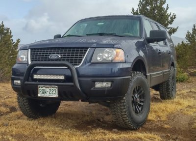

Where'd you get that bumper @MrBlargMan ?
It is called a bull bar. It is just an addition that bolts on to where your front tow hooks go.
They can be found abundantly online for around $100 - $200.
I believe the LED light bar is a 20". A 22" will also likely fit in the same location.
I used a piece of heavy duty square stock steel and long grade 8 bolts to space down and still utilize one of the front tow hooks.
