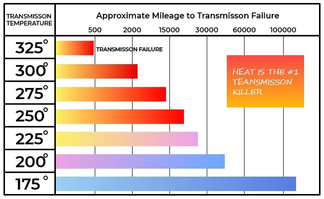

I've never seem any reason to lock out any gears on this transmission with either the 3.73LS gears on the '07 or the 3.31 gears on the '17. HD Tow came with 3.31 that year and 3.73LS was an additional option. Have yet to miss it.
Only towing concerns I ever had was the transmission which will heat excessively if the transmission fails to lock up in whatever gear it's in and this is easily detected if it's constantly hunting (down then up shifting constantly). In this case locking out 6th could be beneficial assuming it locks in 5th. No hunting in my towing experience. Sometimes it just wants to stay in 5th though.
You can watch transmission temperature on the dash. Constant temperature above 225°F for extended (10s of thousands of miles) periods is not good.
-- Chuck
