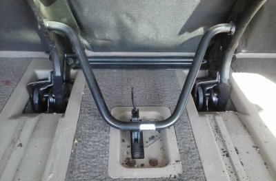

Seriously, on page 102 of my 2000 Owners Manual it has the answer. Tilt the seat forward. You lift the latch up out of the center of the floor so it is vertical. Then you pull down the support bar and it hooks under the latch. It won't go anywhere once you latch it.

Joseph3, I have no idea what latch you're referring to? My '99 has no such latch. They probably decided to correct this idiotic design for the 4th year of production. How did the designers/engineers miss this? There's not much space with the 3rd row in use. There are times when you need to flip it up for more space without taking the seat out. You make the wrong move and the heavy seat comes crashing down onto whatever it is you uprighted the seat for!

Well that explains why I have the setup and the OP doesn't. Mine is just like the TonyRay photo. Sorry about that! So it sounds like the seatbelt method may be the way to go? seems strange that Ford would have designed it that way.. but I am not an engineer.
