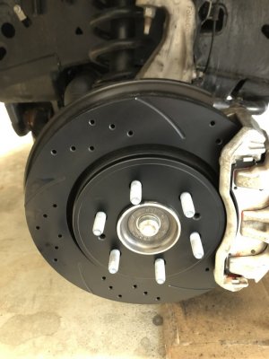

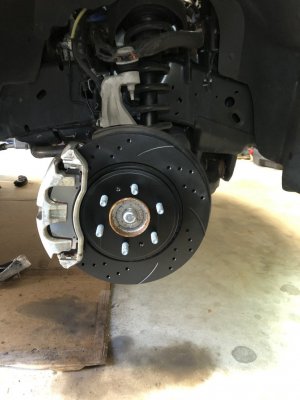

What I put up front. Very happy with them. Also, I installed drilled and slotted rotors 3 months prior. These pads transfer material to the rotors filling in any scoring that may be there.
https://www.autozone.com/brakes-and...per-free-ceramic-brake-pads-de2087/645344_0_0
Rotors used:
https://brakeperformance.com/brake-rotors/premium-dimpled-&-slotted-brake-kit-black-zinc-coating.php
While I was installing the rotors I did a brake fluid flush. Stops like a car now.
