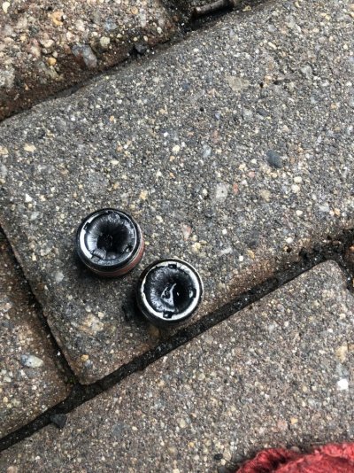

Just to update everyone - I replaced the rear diff fluid and this is what the magnetic fill and drain plugs looked like. Vehicle has 67k and little to no towing and as you can see from the tin man look of the plugs it was good timing to do. There was no large metal chunks and no diff noises but I can’t see going over 100k on original fluid. I have a Max with the 3:31 gearing and 9.75 diff so it took three quarts from the dealer of the Ford Synthetic 75w85 hypoid gear oil. Some non Max vehicles have an 8.8 rear and would take around 2. When it’s out of Warranty and a little over 100k I’ll do it again and most likely go up to 75w110 weight oil. A lot of the Ford F-150 guys go straight to even heavier fluid but are towing very often.
