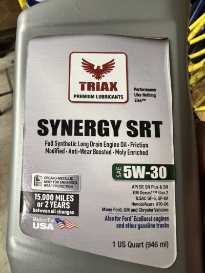

Check out https://www.triaxlubricants.com/
I run this oil in my 7.3 Powerstroke. Night and day difference. I started running it in my expedition. Their oil is specifically formulated for ecoboost engines.

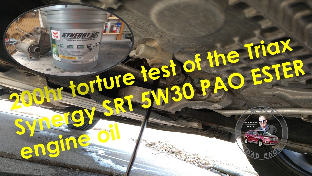

Have you seen any analysis of it? I can look, but was curious if you had come across any?
I read through some forums and watched this analysis review. It wasn’t an overly detailed research by me admittedly. I liked the idea of an oil designed for the eco boost but I would love to hear your thoughts if you look into it.
