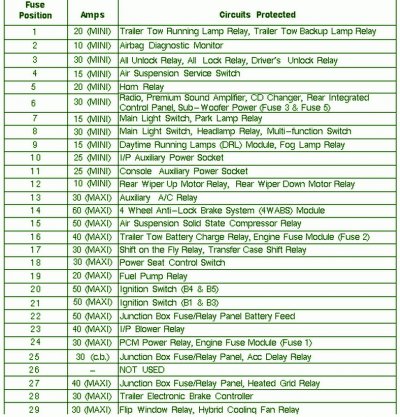

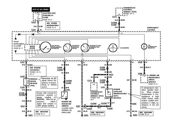

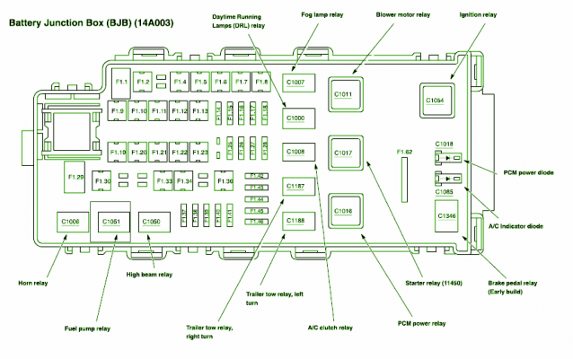

I found some diagrams for you and the rest of us Gen 1 owners in case it comes in handy.
Know what your situations have in common? Running about 2 hours.

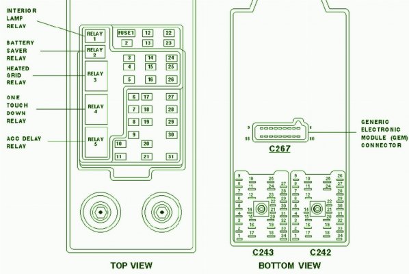

Check the 30 amp maxi fuse under the hood and the mini 5 amp fuse for the PCM. Make sure that the fuses and relays both have good clean spades and reseat them.
I see a PCM Power Diode listed in the diagram, I would replace that too.
There is also another PCM fuse other than the # 24 30 AMP. It is in the smaller fuse box right next to the under hood fuse panel where you were looking at the #24. It is the #1 fuse in the smaller panel. It is a 5 AMP black Ford fuse.
Interior Fuse Box
Instrument panel
