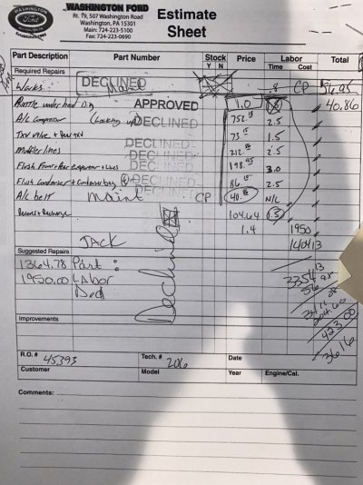

Quick update on the issue. Technician stated on the work order that the compressor failed internally and the estimate at initial dealership is $3,616 to complete all repair work. They provided a parts breakdown and labor time estimation for each.
I will be dropping it off the dealer where it was purchased later this week, so that the third part warranty will be honored, as it does cover such failures.
If the a/c compressor fails out of warranty, it’s incredibly expensive to have repaired…

They are basically changing the compressor and expansion valves. These should be around $600 if purchased online. The rest is just flushing that comes with pretty steep labor charges!
Ford has an old video describing the flushing procedure: https://youtu.be/dn6Q3SRyNTQ
