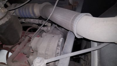

the system has over 80 feet of hoses, as the engine driven compressor is some 39 feet from the condenser and evap and dryer up front.

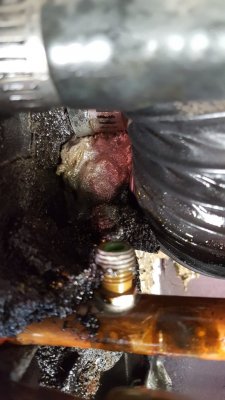

the low side quick connect came off with no fan fare, but the high side shrader valve stuck in the OPEN position when i disconnected the high side quick connect, which promptly bled off a ton of refrigerant and made one hell of a mess as there seems to be some stop leak stuff in the lines and it looked liked expanding foam
I have never used refrigerant with stop leak, but i have no idea what the service center did.

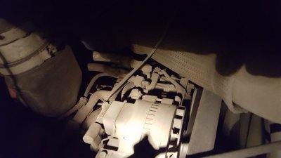

guess i got some shopping to do, o rings and the most difficult..removing the compressor( i need arms with four joints) its a tight wedge for a large man

Use the closest high pressure port to the condenser. Depending on the age of the compressor and the fight of r&r, you may consider putting in a new one. If the front seal is leaking you will pull it out again.
If you do change it there is a bench oiling procedure that needs to be done prior to installation.

If its got stop leak in there you are best to start over! New TXV, new drier, flush compressor, lines,evap and condenser. Get everything tied back in and do a proper pressure test with dry nitrogen. Might even be worth pressure testing as it sits so you can find the leak before ripping it all apart so if you have a leak from a coil/compressor/ lines you can make the repairs all at once.

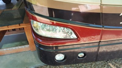

the condenser is directly behind the passenger headlight, it sits about 1 foot back and has a huge electric fan on it. it basically drafts road air from under the front fascia below the two fog lights.. i always thought it needed a direct air duct, but the fan moves a ton of air.

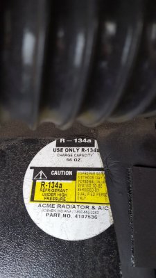

ok..as luck or bad luck would have it, we couldn't leave yesterday. A slide room controller decided to fail. so new parts are not coming until the 11th.
so i went out and found some great numbers for the system so i can get a base of starting point
found a lable stating 56 oz of refrigerant is required
and the part number for the dryer its a parker 21001 or 402815 model with 3/4 inch fitting nuts.
the tx valve has two nuts a 3/4 on the side next to the service port and the other one on the evap is 7/8,
the low side is a 1 1/16.
now are a/c lines sized like aircraft lines as in AN 4 AN 08 AN 10 etc? if so i know the size of the o rings or hopefully parts store has em..
