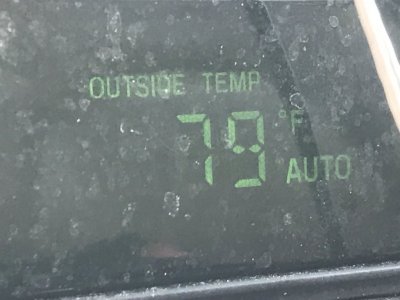

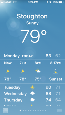

Curently A/C blows at vent a constant 78 degrees. Some what cool depending on the day. Went to check the level this past week end to see if the system emptied out again. When I took the cap off there was some UV dye at valve and some pressure releive, figured that it was no big deal. I know someone will say use a manifold set to check it. I just wanted to do a quick check to see if it leak out as it has for years. Anyway it didn't leak out so the work I did last summer went well. It was 85 degrees out so I should be at 55/379 at most. System was overcharged so I had some purged out now its at max 55/379 and still blows 78 degress.

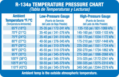

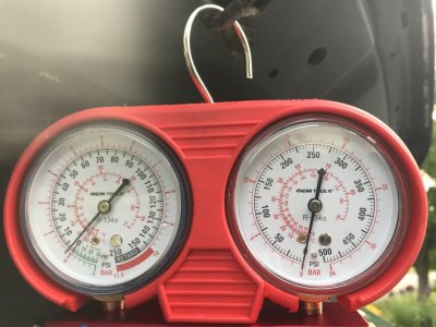

Refrigeration is based on pressures and temps. We need to know the low & high side pressures after running for 10 minutes. And also the ambient temp at the same time.

Readings need to be taken with the blower on high, recirc mode & temp setting on cold.
If the readings stay at 55/379 the system is most likely overcharged or the cooling fan isn't working, radiator and condenser are loaded with trash. The pressures you have are way too high. We start worrying if the high side pressure gets past 325 on the semi's. Over 400 and the safety on the compressor will lift to avoid going "bang".
You can still be overcharged even though the correct amount of refrigerant is loaded. If oil is added beyond the specified amount the refrigerant capacity of the system is reduced.

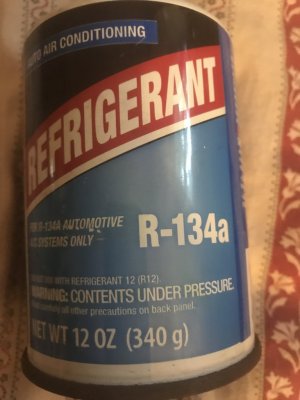

  • No straight R-134A no sealer when the new parts were installed
  • Fresh PAG oil in compressor
  • UV dye through fill hose
This in the last can I emptied (not in the truck).

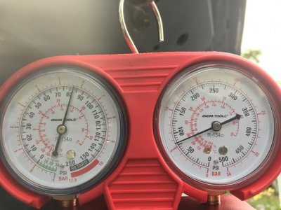

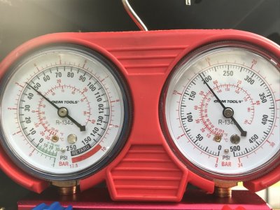

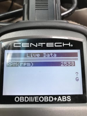

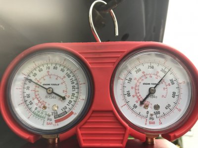

The high side is good, low side it way too high for my liking.
What does the low side read if you run the rpms up?

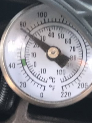

What is the accumulator doing as far as temp goes?
The orifice tube may be letting too much refrigerant into the evap or the evap may be clogged and not getting enough airflow through it. The result of either will be higher evap pressure.
Are you seeing any condensate dripping from the lines or the plenum?
Another thing to watch is how fast it equalizes once the system is turned off. If it is very quick the rear txv could be stuck open.

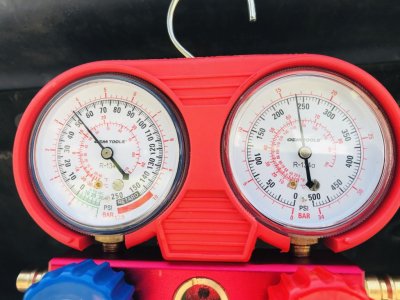

I would use your reclaiming machine and recover a little of the refrigerant......I can't tell you to blow a hole in the ozone layer if you don't have a machine though.
That will lower both the low and high side pressures.
Here are your capacity amounts:
1998-2002 All Engines w/ Front & Rear AC ... R134a 62.00 PAG 46 11.00oz
How much oil did the compressor manufacture say to add to it?
Above you stated that you added .8oz to the compressor and then 3 oz to the system. Need to determine about how much oil is really in the system.
Did you check the color of the orifice tube to the one you pulled out?
