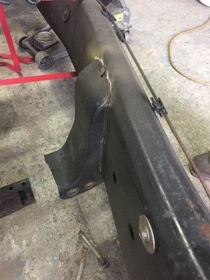

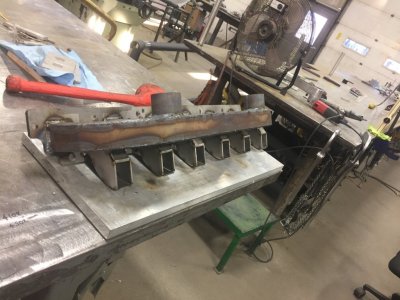

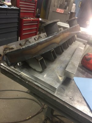

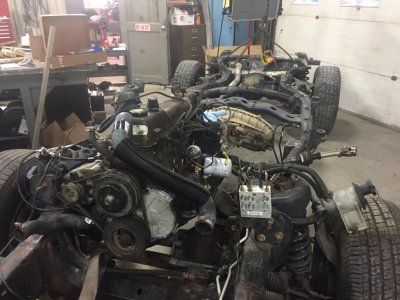

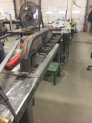

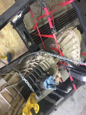

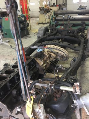

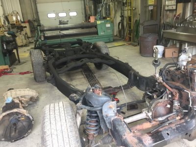

    8008225F-969C-44F3-9E27-87B7E8DACFE1.jpeg 1750CA16-97C4-4700-B397-DD0E9594CCFB.jpeg 1153C809-EAF1-40D0-B2DA-D3249D8B2D48.jpeg 758DA7E8-36A3-4E03-BDAC-D6C562AEBC19.jpeg 4EA8CD42-78B4-4CA4-BB77-B27705022C7F.jpeg Building my own vehicle and liked the 2gen expy chassis so I went with it! Transmission and Tcase out of a 1996 F350, ZF5-47 can’t remember what Tcase it is. Motor: Carbed 300 I6. Going with a dual single barrel carb setup with custom dual plane manifold and headers! Frame is cleared of rust and the back half is coated! Got my tranny crossmember moved today! Going to get my motor mounts fabbed up and welded tomorrow...hopefully. Plan for the body is till cage with sheet metal styled after a VW Thing!

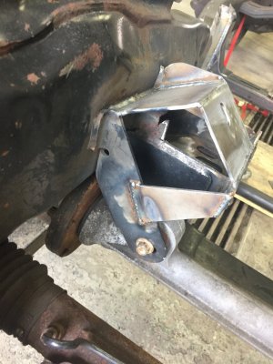

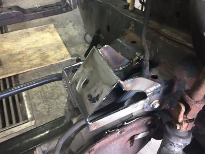

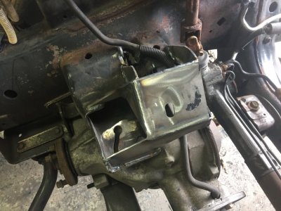

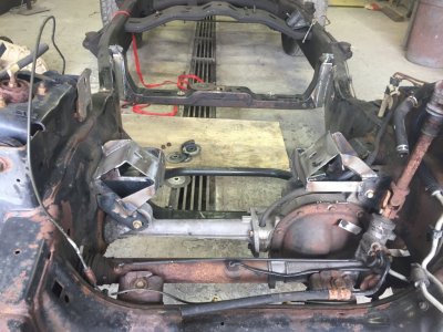

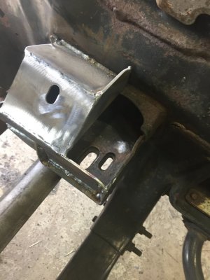

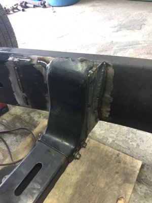

    491E4C19-4001-458B-B150-EBB38F48A40F.jpeg 8B6AE3BF-14E6-42AD-BA7E-D01BBFE2C632.jpeg A23CF840-434F-4B57-B09C-EF10CD67101B.jpeg 31829F50-BAF4-465D-AAF4-BA6BE27AA5BD.jpeg 8FC8BCC3-2E2C-4905-BB10-C117660A06DF.jpeg
    Onroad.
    Got my motor mounting points all happy hunky dory and welded today!

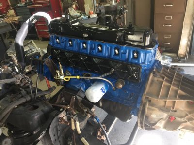

    Got my motor and transmission mounted and the motor painted! Should be ready for break in the next few weeks. My dang custom dual carb intake/exhaust combo ran into a hiccup. The exhaust ports are to long and the one was crashing into the alternator so I have to rework that and while I’m at it probably convert the dual carb to a single 4bbl for future boost application.
    4620CF2A-116E-4C75-96AF-C74D5585550A.jpeg 24D57F55-E146-4CE8-AA3D-804C2DF0645F.jpeg DBBC86AE-97DA-4E21-9F5D-CDD2E5590091.jpeg 011B5ECA-26CE-4E09-BF6C-1C0A3446F5CD.jpeg E2109772-81A2-4B24-82CF-0E101361C055.jpeg 011B5ECA-26CE-4E09-BF6C-1C0A3446F5CD.jpeg E2109772-81A2-4B24-82CF-0E101361C055.jpeg
