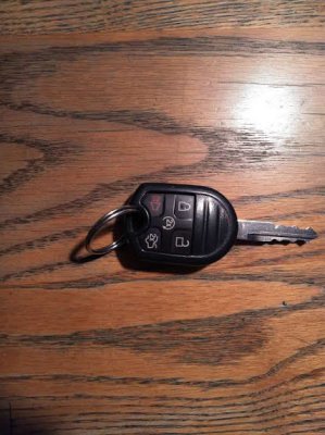

I'd check forscan 1st, and if the remote start in plain English option is available to enable, then it try some key fobs. My 17 xlt just needed enabled in forscan. And I have a regular key style fob, so those were like $40 on amazon for 2.
