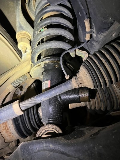

Replaced my rear CCD shocks because they were leaking. 2k job at the dealer in Jan 2021. I think they are shot again...
