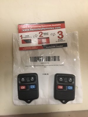

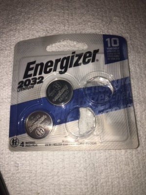

This post reminded me that I need to replace one if not both of my 2 OEM Key FOBs. So, I ordered a pair of aftermarket replacements from Amazon for $15. I also ordered some Energizer CR2032 Lithium Batteries. Most all products that use batteries and come with batteries in them, come with no-name batteries. So will upgrade the batteries right out of the gate. All this is due to arrive over the weekend and I'll have to program them and see how they work. I'll report back on the results.....

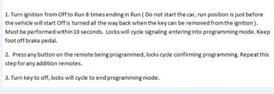

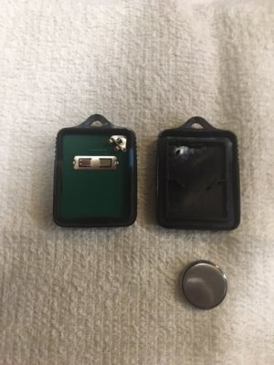

The fobs arrived and I swapped the batteries. Then went out to the car with the key and the fobs and followed the programming instructions. It went smooth and worked right the first time. Fobs are working great.
