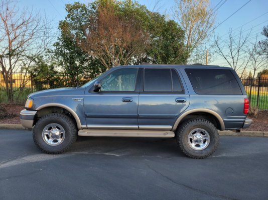

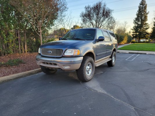

The front end feels quite stiff. Not sure how much is due to the KYB shocks vs the torsion twist I did to level the front w/ the rear height (with coil spring spacer). I will probably drive it for a few hundred miles to see if the shocks settle a bit before trying any changes.

Latest update - I've driven about 1,000 miles since the install, mostly highway towing miles. Not much has changed as far as how the ride feels. The stiff front end isn't too bad for on-road comfort. I have 0 miles off-road since the install, but I imagine it is not great for articulation. I still have a tiny bit of rake that bothers me so I might go to a shorter rear coil spring spacer at some point and potentially back off the torsion keys a little bit. It would probably require more trimming of the front bumper and running boards (which I finally just got dialed in) so I am just going to drive it as it is right now.
