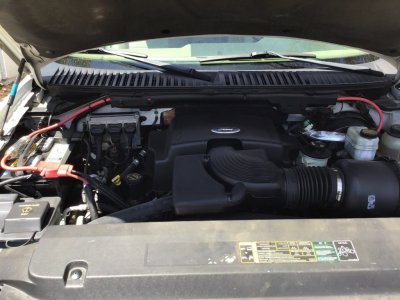

Gotta question. Any ideas of a good spot, on the battery side, to run 0 gauge power wire thru the fire wall? Poked around a bit, but cant find a place to run it. Any suggestions would be greatly appreciated.

There should be a dimple on the driver side around the valve cover that is used for the clutch master cylinder on the sister trucks. The passenger side is loaded with a/c and heat goodies.

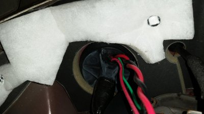

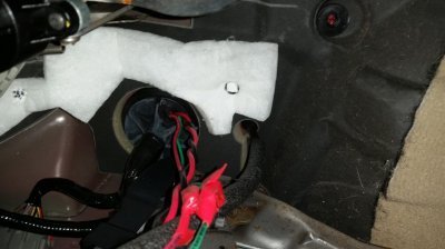

I wired my 08 with my fire department lights and had to run a 12 power and a 12 ground through the driver side. I pushed through a HUGE grommet under the dash on the driver side. I need to run about 4 more 16g through it and there is plenty of room.

couple pics of the grommet i went through

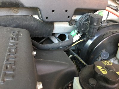

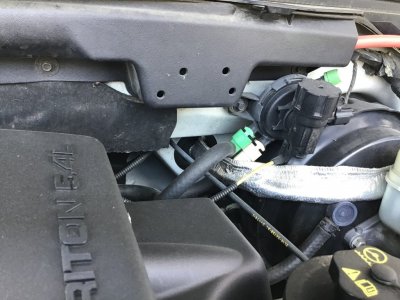

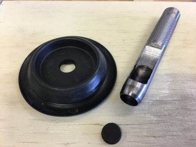

This what I did on my 2004. There was 2 1/2 hole in the firewall that had a big rubber plug in it. I removed the plug and stamped a 1/2 hole in the center of it. Made a nice air tight grommet.
