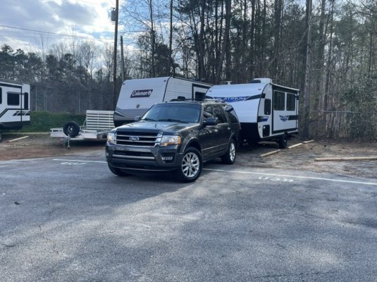

I’ve been towing our 4000 lbs TT with an Andersen and pretty happy. I don’t really have a frame of reference with other WDH, but it tows great and can’t really feel any sway. I do disable the sway control on the Expy towing screen.
