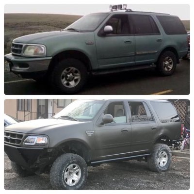

Gonna be watching how you do.. I’ve researched a few of your choices already, and your shopping in the right places.. I don’t see any pics showing up, but maybe my phone is trippin out today.. I found a set of 4” lift springs for the first gen expedition I would have liked but I went a different route myself due to zero income and being disabled.. I am anxious to see your progress. So many people say they an expedition isn’t capable of wheeling, but I have proved them wrong,lol, ready to see you do the same.. Good luck, can’t wait to see your progress.. Just for ***** and giggles, here’s my toy.. IMG_8174.jpg

Also, great choice in tires. Mines sitting on 33” pats in the pic.. I am going 35” soon.. got 3 years out of them without ever rotating, and would have gotten longer if I didn’t have posi rear.. the front still have life.. the rear are toast.. Pat’s do everything you need from a tire..
You’re going to need a longer panhard bar as well, at 4” your gonna pull the axle to the drivers side quite a bit.
