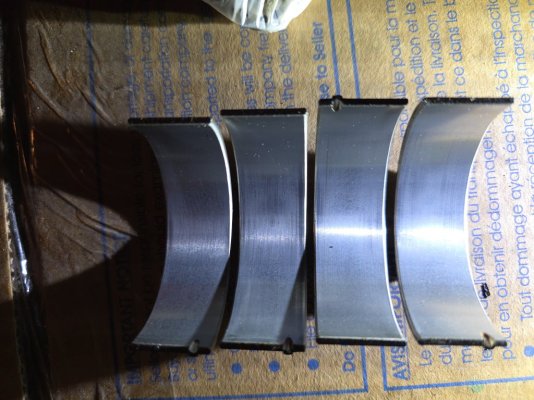

Another question. While I have the pan off, should I do rod and main bearings? I have 180k and a little chain slap. My hesitancy is that they are TTY bolts that may be tough to source, especially since there are side main bolts too. I'd appreciate the knowledge @whtbronco and @Hamfisted . You guys are my heroes lol

Honestly the only way to know about the main and rod bearings is to judge the wear you see on the heads and timing chain parts. From that decide if you want to pull a cap from the crank to check. If I was to replace the main and rod bearings there's a good chance I'd take a look at ARP for replacement bolts. I'm not a big fan of TTY bolts. Though the cost of ARP at times sends me back to replacement TTY bolts. I gotta say if you get the heads rebuilt and replace the crank and rod bearings I would without question hone the cylinders and replace the piston rings. I mean heck you'd have darn near a new engine.
The bolts look to be readily available which is good news, but dang they are costly bolts.
Ford F65Z-6345-AA Engine Crankshaft Main Bearing Cap Bolt
Ford F3LY-6214-A Engine Connecting Rod Bolt

I'm curious how this job turned out. Especially the R&R of the main and rod bearings.
