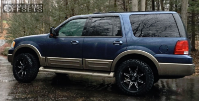

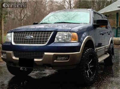

anybody have pics with 275 60 20's

currently i have the 275 55 20's Hancook dynapro all terrain. i would like to have a more aggressive, taller tire. i don't really want to do a lift, if i did, it would be something minimal like a 1.5f/1 rear. i tow a lot so i want to keep some rake in it. i also drive a lot so i want something that still handles fairly well on the curvy roads of the ozarks. I'm basically looking for the best of both worlds. I think that any tire over 33 inches i would want to regear and i would like to avoid that if i can but i may do eventually. i know that the 275 60 is just about 1 inch taller and that doesn't seem like much, but i am thinking that it may be just enough to accomplish what i am going for. all the pics i find are with much larger tires.
