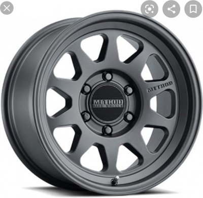

Looking to upgrade the tires and wheels as not a huge fan of the 22s. Going with a 18 inch woth +18mm offset 9 inch wide rim.
Wondering if anyone is running a 295 70 18 on stock setup or if it would rub? I know a few guys had the raptor setup with slight rub but was that from the width or the height?

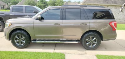

I am running a 295/70/17......on 1/4" spaced raptor wheels (that are -10mm) and lifted 3/2". There is no rub and finger clearance. A wider tire will rub for sure. A taller one might also. A taller and wider tire most def will. I think the raptor wheels alleviate the UCA rub so long as you dont go crazy on tire width.
Im betting on stock height and wheels....you will run a little.

Thanks all probably just play it safe with a 275 70 18 its about 33.5" tall and only 11" wide the tires I want come in both sizes but the 295 70 18 is 34.5" tall by 11.8" wide so might be too stuffed on stock suspension but looking at putting these wheels on it.
