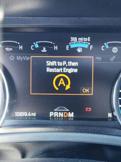

I took a picture of the message on the dash. It is very repeatable. I can't believe the battery is going bad at two years old and 10k miles.

If u turn off ass, will it still turn off when u stop?
No. It's definitely an issue with ass. If ass is off everything seems fine. I'm taking it in next week. It's still under the full bumper to bumper warranty.
That is just the problem. Two years and 10k miles. Vehicle sits too much for batteries this day and age.
