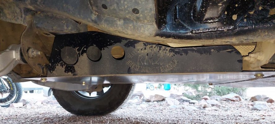

Alright boys and girls, this post is long over due. Had the rock sliders done for a little while now but I have tons of pictures from the whole process, and these forums don't really have an integrated album option. I'll post a few pictures and describe the process here, but the full album can be found here: https://ibb.co/album/8bK2gZ

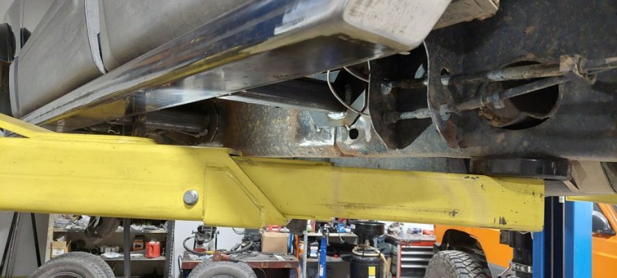

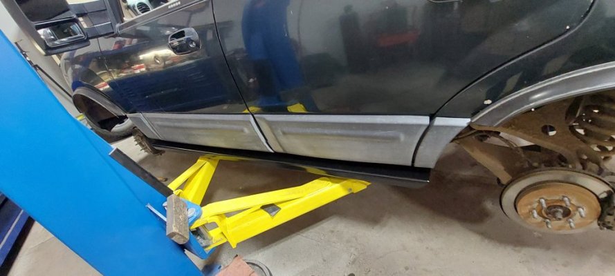

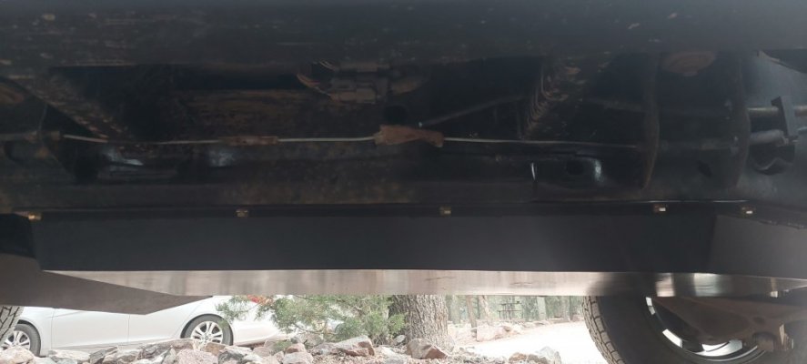

For the main bar that sits under the rocker panels, I used 2x2 0.180 wall square tubing, and for the rest I used 1.5" OD 0.120 wall DOM steel. Used the tube bender to eyeball the initial bends and cut them to size. Hardest part was definitely making all the notching in the tubes that I used as supports between the square tubing and the round tubing, especially because I didn't have a tube notcher. Just used a cut off wheel, angle grinder, and a lot of back and forth & test fitting to make sure the cuts were right. Once I was happy with the fitment of everything, I welded it up then ground down any ugly welds (of which there were a few. lol.) and am now working on a way to attach them to the frame. Still on the fence about bolting it or welding it to the frame. Welding would definitely be stronger, but if they break or are damaged it would be a lot harder to remove so I could put on new ones. My biggest concern is the e-brake line on the driver's side. Its smack-dab in the middle of the frame, making it harder to place the standoffs than it is on the passenger side. Open to any suggestions as always!
Once they're attached, I'm planning on painting them with some black bedliner to give them some grip when they're acting as running boards.
Starting out
Test fitting and cutting out notches in supports
Welded up, besides the endcaps. Ground down some of the big ugly welds on the one on the left.
Welded up a quick little jig to hold the sliders at the right angle. Super happy with how it turned out. Angle of the slider matches the rocker panels almost perfectly. Going to leave an inch or two of space between the top of the round tubing and the bottom of the door once I decide how to mount them. Decided to go with an over-built approach. I want these to be able to support the entire weight of the truck, and if my back of the napkin math is correct, these should be more than up to the task. With only about 5 inches needed for the standoffs from the frame to the sliders, and the fact that I'm using the 2x2 for the standoffs, I should be able to get away with only 3 per side. May do 4, but I don't want it to take all day to cut off if they ever need to be replaced.

Thanks!! Hope they stand up to the abuse I'll be throwing their way! Still mulling over the best way to attach them to the frame. Im thinking some 3/8 steel plate, something like 3x3 welded onto the frame, then weld the 2x2 square tubing onto that so they arent attached directly to frame and will spread out all the force being applied to them over a greater surface area. And hopefully the plate welded to the frame will give it some extra rigidity and make it less likely to buckle in that spot.
