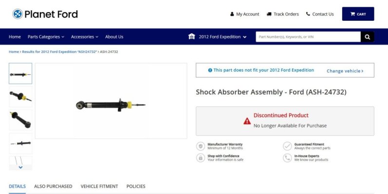

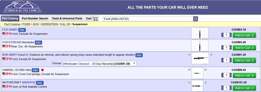

Order Motorcraft ASH24732 from rockauto for $35 each and scrounge what you need. Cut off the end with the mounting eye and bushing and the spring seat will slide right off along with the spring isolator.
