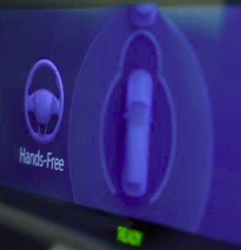

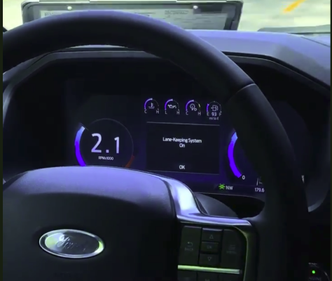

You have two different "modes" of BlueCruise...
1) if the whole dash is blue: BlueCruise is on, no hands required
2) if the dash is normal and the lane lines are just marked in blue, you are not in a BlueCruise area or it is not available for one reason or another.
Thanks for explaining; I wonder where I might find an example of "the whole dash is blue" so I know what I'm looking for.
Below is a route I drive most frequently, and I swear the first time I looked at BlueCruise maps the whole thing was blue. Now that I look again it clearly is not, and this likely explains why sometimes "HANDS!!!" appears and sometimes it does not.
I suppose there is a youtube somewhere that shows what a "no hands required" dash should look like.
Never mind I found it. I dunno I have ever seen this:
Anyway I be gonna study this video. Congrats BTW on yr A&M degree!
