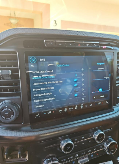

Lane change assist, in-lane repositioning and predictive speed assist while taking turns on BC. I've had the new features on my 2021 for longer than I can remember at this point.

It is a 2021 Platinum, but an F150. The architecture of the module network is very similar though, which is why I think it can also be done with the Expo's. The few VIN's I have checked of 2024's shipped with the latest IPMA software in it which means the new features can be activated with FORScan. I don't have one of these trucks to tinker with it. If you have FORScan and aren't afraid of experimenting, we can try to enable it.
I wanted to post a follow-up to this as a few people have reached out to me to try to get this to work. At this point, I will have to say that this is NOT possible with the Expo's yet. We've tried everything to get this to work.....even side-loading the IPMA software off of my truck with BC 1.4 into a 2024 Expo Platinum and we still could not get lane change etc to work on an Expo. Even though the latest IPMA software available for the Expo's is the BAE strategy which is BC 1.3 on the Mach E, it seems that the software stack for the Expo's does not contain the events for BC 1.3. Either that, or there is some config missing from the GWM that is preventing it from working. However, since none of the FORScan spreadsheets breakdown what the config in the different lines of the GWM actually do, it is impossible (for me anyway) to know what to play with in the GWM to try and get it to work. So at this point, I am waving the white flag on this project and giving up until Ford releases newer IPMA software for these vehicles.
There was only one case where we were able to get it to kinda work, and it was by side-loading the BAE IPMA software from a 2024 Navigator onto a 2022 Navigator. If memory serves me correctly, we were able to get lane change assist to work, but not predictive speed assist or in-lane repositioning. In the case of the Navi, the toggle switch for lane-change assist was not turning on on the touchscreen, but the feature itself was working. In the case of the Navi, we really dug deep into trying to get it work. @jlbarstad Did you ever keep messing with this on your Navi to see if it worked?
