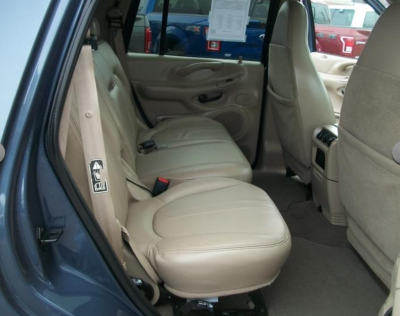

I found some pics online of various years/trims with benches, including a 2001 Eddie Bauer, yet my 2001 EB clearly came with buckets.
^ 1998 Eddie Bauer
^ 2000 XLT
^ 2001 Eddie Bauer (looks like a bench to me!)
Can awesome folks here shed some light before I get into this project? Is there really a difference in floor mounts in 2001 between the above pictured bench, verses bucket seats? After which, my questions above become important. Thanks!

I've looked at a dizzying amount of 97-02 Expeditions only to conclude that this is NOT a direct swap to go from Bucket to Bench or vice-versa. Dang it. The floor body is the same, but the bolts and more importantly BRACKETS are NOT the same - no bench utilizes the same mounts as the buckets. There are clearly places where they would go, but simply aren't there (factory differences).
Basically, it seems the bucket setup is like the right hand-seat, mirrored over to the left (as opposed to the left side being a wide 60 of a 60/40 split). See below, the mounts of my buckets match those of the right hand "40" part of the 60/40 split:
^ Bucket seat, locking clips in the back, and 3 bolts in front (horizontal foot pattern on the right)
^ Bucket seat from behind, the two locking latches/clips
Now see the floor, literally a mirror of what you see on the right bucket is a mirror for the let bucket match of the pair.
^ Floor, pic taken sitting in front seat aiming toward the back. Notice TWO sets of bucket seats, mirrored. The left is similar/identical to the "40" of the 60/40 split bench.
IMPORTANT: what most critical thing missing is the vertical bracket for the wide seat latch. Look at the 4 horizontal brackets here, above the 3rd one over is the metal frame, and you can see a flat spot where a vertical bracket WOULD be welded in for the "60" part of the 60/40 bench.
And finally, with the carpet pulled back, you can see that the floor is the same as all ya'lls bench setups, except that the single vertical locking bracket for the "60" wide left hand side of the bench is missing, and the two horizontal brackets for a bucket are there. And the bolt near the center ridge where the wide seat (left hand seat) would bolt in.
^ Carpet pulled back, this pic is taken from the rear facing forward. Note the bolt holes on the right are similar/identical to the "40" of the 60/40 split, BUT that same pattern wont work for the wide seat that would sit on the left here! On the left is yet another bucket i this case.
The frustrating thing about this is that situation is apparently not a problem for the FRONT seats, wherein apparently a F150 bench is swappable with Expedition Buckets!!! -> i.e. compatibility across different vehicles, rather than total incompatibility even within the exact year/make/model/trim for this dang 2nd row. What the heck man? Middle seat total rip-off. Change your mind about buckets and benches here - great, change vehicles, not seats. Lame. I so don't want to weld bolts and brackets - moving all sorts of underbelly things out of the way to do so. Way too involved.
