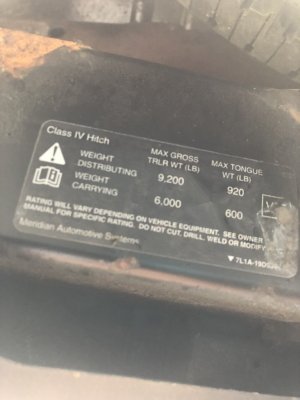

An Expedition with the tow package can take up to 600 lbs on the hitch. If you are only getting a popup the truck won't even know it's there. I tow a 5000 lb boat with no issues. You won't need a WDH.

@John Christopher so there are some popups that push close to 4500lbs loaded ... add 1000lbs of people, luggage, and gas in the vehicle and we're getting close to the 6000lb tow limit. But I agree with you, I'll wait on a WDH until I feel the need to invest in one..
