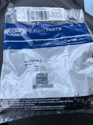

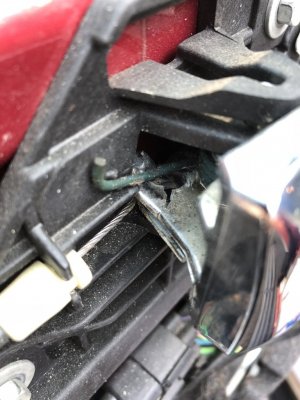

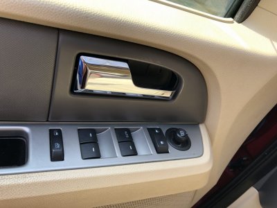

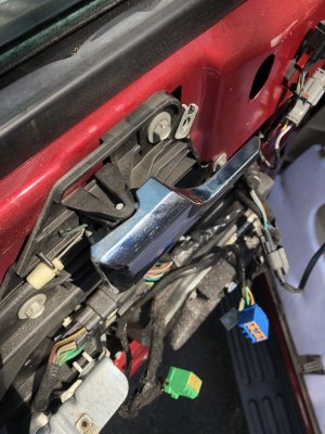

Ok so if this happens to any of you I got it done. It’s about a 1 minute repair. All you need is a 7mm and a screwdriver. Pop the door panel off and then lift up on plastic where the handle “axle” goes through and pull the old handle out top first (shown in pics) Then put cable into new slot in new handle and reverse the process to put back in, then just throw the panel back on. Part number for the handle is on the part bag.
View of old:
New part:
End result:
