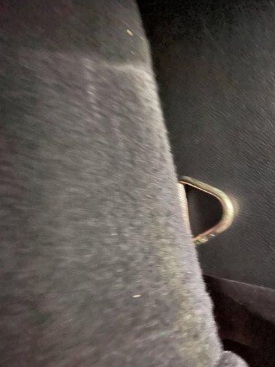

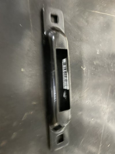

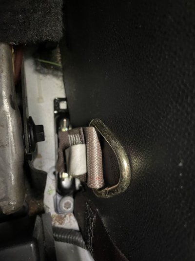

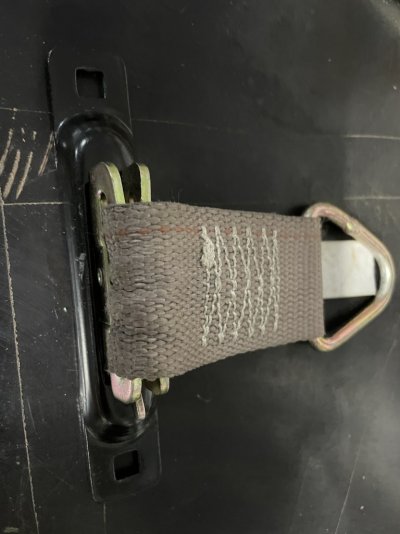

I have a 2014 with 3rd row seating and this is what I did. This was stuff left over from a van conversion. No drilling and mostly out of site. There are single point E track tie downs that I bolted 1 side down with the seat belt anchor bolt. It is not as strong as using 2 bolts but I have a trailer for the heavier stuff. My goal is to keep things from flying forward God forbid I have an accident.
