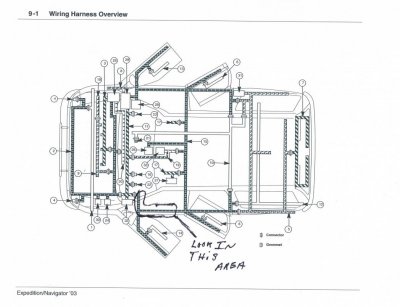

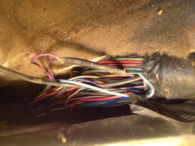

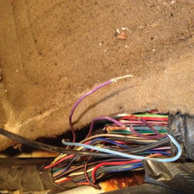

After locating, removing and checking almost all the modules and their connectors, I found the problem. The violet wire (ubp circuit) that runs to all the modules (stability assist, climate controlled seat, parking aid, vsm etc...) was broken.
It was broken under the drivers side kick plate about 6-8 inches from where the wire bundle comes off the A pillar. The union from 1-3 wires is where it was broken. The ends of the break were corroded. I'm not sure what caused it to break but, once I fixed it, all the issues went away except for the check advancetrac message, advancetrac off issue.

Just wanted to throw a MAJOR thank you out there. After an incredible amount of time troubleshooting this this issue (over a year on and off and endless $), I stumbled across this thread and read your post. Last night, I pulled the kick panel off and immediately saw the violet wire going into the 3-way. It looked fine but I figured I'd split it apart and check anyway. To my surprise when I cut it apart, all 4 ends of the wires were broken and green from corrosion. A simple connector and some tape resolved all of the issues. I assume this issue is caused by the dreaded water leak these things have. Nonetheless, it is all back to normal. I built these things for Ford for 10 years at the Michigan Truck Plant and know them inside and out but this issue....WOW, it was a tough one. Again, thank you for taking the time to repost and share your fix.

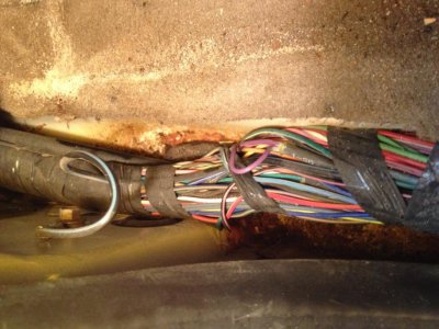

Another one fixed thanks to this thread, unbelievable !!! Just wanted to add this also fixed my seat heat controls, 4x4, rear lift hatch, radio won't shut off problems... Thanks again for taking the time to write down your experience , without it, I was going the complete wrong direction, and probably would have spent a fortune at ford... Just want to add that the placement of the wires in question were purple/violet, on the floor, so I needed the sill plate as well as the kick plate off, I got confused for a bit.. But whoever this helps out next.. They are the 4 purple wires sliced together, on the floor... Thanks again
