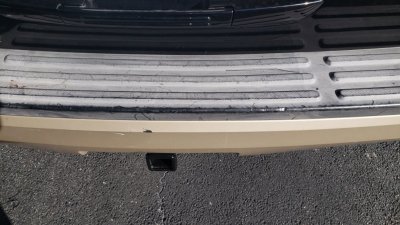

Cleaning up the rear bumper step trim?
Kevin08
Jan 27, 2021
210
53
Illinois

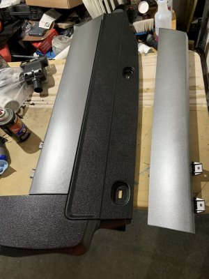

Duplicolor flat black vinyl & fabric spray on the latch trim compared to bumper pad not yet done.

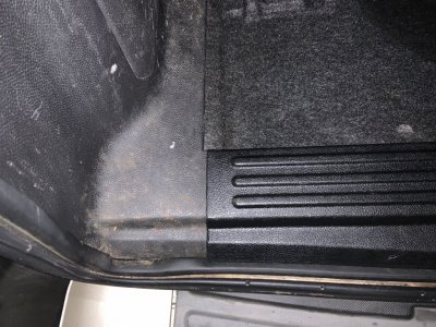

Guess I’m committed to recoloring all the interior trim panels now. The side panel hasn’t been cleaned yet. I wasn’t sure I wanted true black over the oem dark charcoal, but I like it better clean & new looking. Original finish is looking bad even after cleaning.

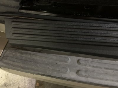

Did you do the bumper pad yet? I got my new one and need to know how to get the old one off. Haven't been able to find any info on this, hoping I don't have to remove the whole bumper.
Hamfisted
Nov 20, 2012
2,593
1,474
Ft Lauderdale
You have to remove the rear bumper facia to change out that trim pad. No way to get to the fasteners with it on the Expy.

Sorry I haven’t done mine yet. I was focusing on the interior while waiting for the new transmission which has arrived. I maybe be back under it today. I’ll look and see if/what’s blocking access to the clips. Usually they’re a squeeze/pinch to release style
Kevin08
Jan 27, 2021
210
53
Illinois
I can’t even see any of the clips. The steel bumper/receiver hitch fills up the entire cavity and I can see another plastic shell on top of that. So I think Hamfisted is correct, easiest if not only way is to remove the cover. I’m planning to paint all my Eddie Bauer tan to the newer King Ranch accent color, so I’ll take my bumper covers off later this spring. Looks more like milk chocolate or coffee color. Can’t find a paint code on it yet. Might be the Caribou Brown on the new Ford trucks. Anyone know that color please tell me.

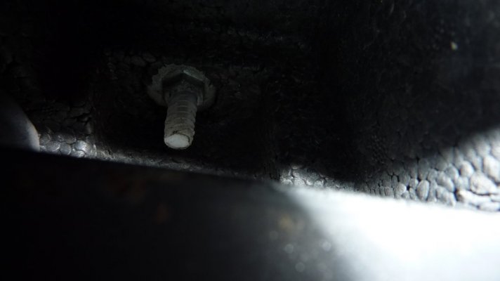

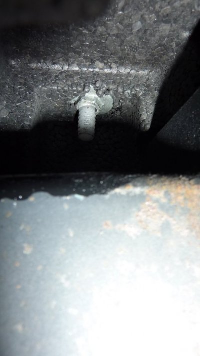

To get the bumper step pad off you just remove the two 13mm nuts on each end and pop the pad off. They're those self threading nuts that screw down on a plastic "bolt" shaft that's inserted in the pad. To re-install you just smack it back down in place and re-attach those 13mm nuts onto the shafts. If you can get a 13mm socket or wrench ( Gearwrench FlexHead Box Wrench ? ) on those two nuts from underneath you won't have to remove the bumper, but I couldn't, so I just removed the whole bumper and set it in the grass to avoid scratching the paint to work on it. These are the only fasteners holding the pad on, and they also secure the foam insert in the bumper. There is one harness plug on the driver's side of the bumper to unplug to free the bumper from the Expy once the bumper fasteners are removed.
